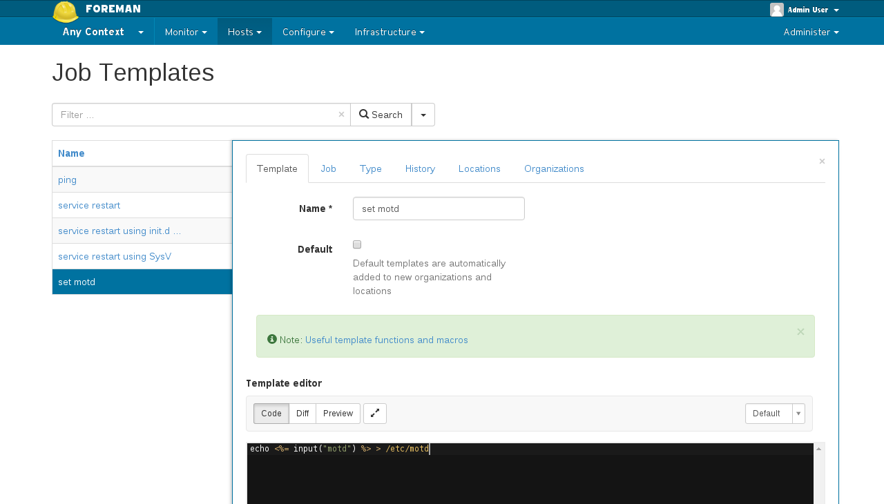

3.1 Job Templates
If you’re familiar with Foreman provisioning templates, you should find writing job templates familiar. First navigate to the Host > Job Templates menu. Then hit the green button with label “New Job Template”.
Note: If you don’t see a menu entry, the Foreman plugin is not installed correctly.
Now you should see a form similar to the Provisioning template one. In first tab you have to fill in Name. You can use input macros in ERB tags which stands for variables which you define in second tab called Job.
Job Template form
Before we get to inputs, lets look at other fields in Job tab. First one is an autocomplete field called Job name. This is generic name of the Job, which might be implemented by more than one job template. For example, one template may use yum to install a package, while the other uses dnf. At invocation time you can choose which template to use.
This is more useful when more than one provider is available. For example, you might have both an SSH and an Ansible template that implements the “Install Package” job. It turned out that having two names is so complicated that we decided to merge template and job name in some upcoming version.
A description format field is a template for job name. Imagine you run job template named “Install package” 10 times, each time with different package name specified by user input (more about this below). On job overview page you’d see the same “Install package” job and you’d have to inspect provided inputs to find the one that installed let’s say httpd package. Using description format you set your own rules for naming which can use input values as part of job names. In our example install package example a good description format would be following
Install package %{package_name}
Note that the name wrapped in %{…} is the name of input which value will replace this placeholder so you would see “Install package httpd” if httpd was used for this input. Note that the description format can be modified per job invocation as well so this is just a default value for particular job template.
On the very same tab you can configure inputs. These template inputs defines values that can be accessed in the template itself. To add new input, click the green button “+ Add Input” which adds more fields to the form. To remove the input, hit the cross in top right corner of the input form.
We support four types of inputs. Each must have it’s name which is used in macro. If my input has the name “motd”, I can then use following ERB tag in my template code:
echo "<%= input('motd') -%>" > /etc/motd
The way we determine the input value differes based on Input type. Let’s start with User input. This input always needs the value to be specified by user. It means when user runs the job, we display the field that they must fill in, or provide options to select from. The provided value will be used as a result for the corresponding input macro. Whatever you put in Description field will be displayed to the user so he knows what’s the purpose of this input.
The rest of the types load values from the host and do not require any user interaction. Since the template is always rendered for a specific host on which the job is executed we load the value this host data. These data can be either Fact (coming from Puppet/Salt/Chef), smart class parameter (when you use Foreman as Puppet ENC), smart variable or a parameter.
If you want to load value from host facts, use Fact value input type. You’ll have to specify the Fact name so Foreman can match the right fact. If you make a mistake or the fact is not present for a given host, the rendering of template will fail and hence the execution on this host will fail.
If you want to use a value from smart class parameter, use Puppet parameter input type. you’ll have to specify puppet class name and the name of its parameter. It’s the value that you can see in ENC YAML under classes key.
If you want to use either smart variable or parameter, use Variable input type. Both of these values are part of ENC YAML under parameters key overiding each other if they have same name. You have to specify the name of either parameter or smart variable.
If you’re confused about the difference between smart class parameter, smart variable and parameter, checkout Foreman manual parameters section
Note that until inputs are saved the preview of template won’t work. To review the template first save it and then get back to the form and hit Preview button.

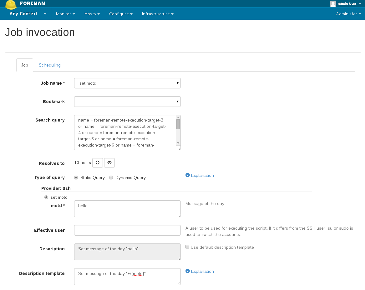

3.2 Executing a Job
To execute on one host, go to the host detail page and click green “Run Job” button. For multiple hosts, use the bulk action tool on the “All hosts” page to select “Run Job”.
Job Invocation form
In this form you select which Job name you want to run on selected host(s). Then you can see prefilled Search query that uses the Foreman searching syntax. You can customize the query to search any set of hosts, e.g. all hosts running CentOS 7.1 or hosts with 1 GB memory. You can check how many hosts such search query covers by clicking refresh button below.
You can also specify Type of query. Currently we support two options
  • Static query - evaluates the search query immediately when you hit the Submit button and saves the resulting set as the target of this execution
  • Dynamic query - stores the search query and does the evaluation just before the command is executed, which means if there are new hosts added meanwhile, the job will be executed on them as well
Dynamic query will be more powerful when we add scheduling job executions in future. Also it will be useful when Bookmark is used for specifying the targets. To review the list of target hosts you can use the button with eye icon. It will display the list of hosts matching the search query.
Then there’s the template selection. If you have multiple job templates for a given Job name you’ll have to select one. If there’s just one like in my example, you’ll just have to provide values for all user inputs.
You can override effective user for this invocation unless it was forbidden for selected job template. In non-editable description field you can see the name of job that will be used after you save it. You can also override description format by unchecking Use default description template checkbox and providing your own template in Description template. You can use placeholders that will be replaced by values of inputs with corresponding name for example if there’s input with name service_name you can specify the template like this
Restart service %{service_name}
If you set the input value to “httpd” the resulting description would become “Restart service httpd”.

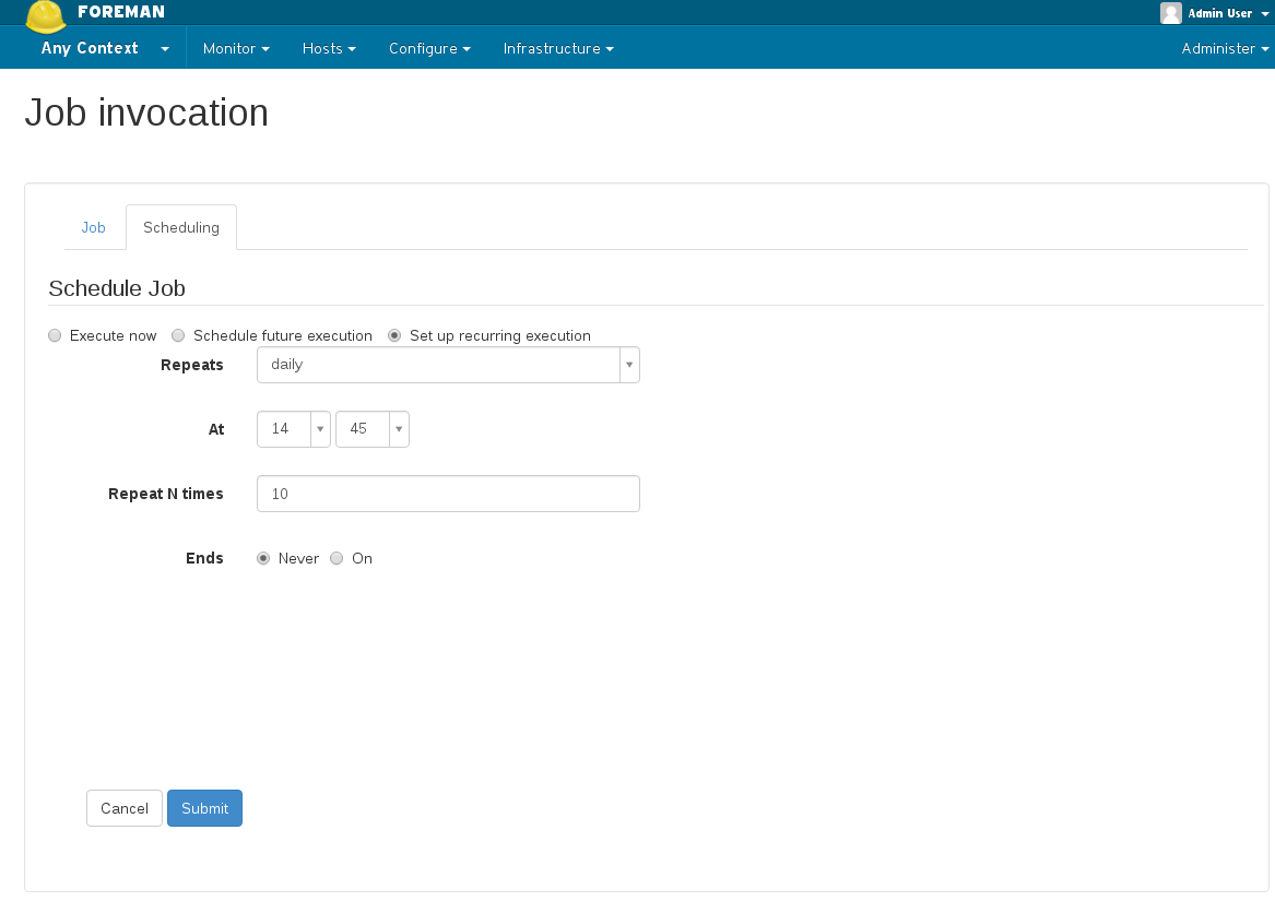

You can also plan the execution in future or configure multiple rerunning. There’s a second tab called Scheduling where you can choose from
  • Execute now - immediate single execution,
  • Schedule future execution - delayed single execution
  • Set up recurring execution - multiple executions on regular basis
Job Invocation schedule form
While execute now is obvious, future time scheduling offers you to customize two things. First is when the job should start, the second one called Start before determines the deadline after which the execution shouldn’t start. This can be useful when you have some maintenance window and if the execution gets delayed it wouldn’t be safe to run when the window was closed.
When settings up recurring execution there are many ways how you can specify the interval. You can choose from hourly, daily, weekly, monthly interval basis and for advanced users there’s option to specify custom cron configuration. This way you can setup various intervals, for example

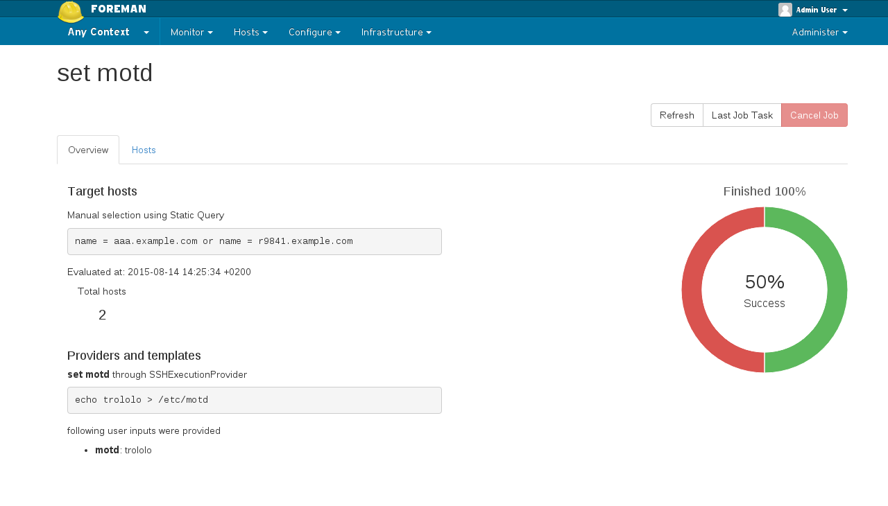

3.3 Job detail
On the Job detail page you can see overall progress and result of the job execution.
Job detail 1
In the overview tab you can see what query was used to find the hosts and how many hosts were found using it. Below is the evaluated template in generic form. If there were some fact or parameter inputs used, you will see only placeholders for them since they are specific to each host. User inputs are evaluated since they are same for all hosts. A chart is showing the status of the job on all targets.
From this screen you can even cancel the job if it’s not finished yet. First cancel attempt will try to cancel the run on the Smart Proxy. If proxy does not respond, you can hit the cancel button a second time which forces the Job to be cancelled on Foreman (while it still might be running on Smart Proxy). Last Job Task takes you to Foreman Tasks that represents this Job.
In Hosts tab you can see all hosts targeted by this execution, status of the job on them and link to Foreman Task that represent the execution for a particular host. Note that this task is a subtask of a whole Job task.
If you scheduled a recurring you’ll also see Recurring logic tab. This gives you some basic information, e.g. when next run is supposed to happen. After you cancel the job, it cancels all future executions as well.

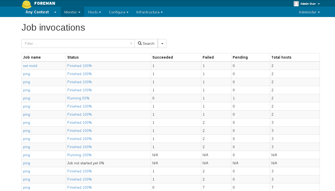

3.4 Jobs list
You can find all Jobs when you navigate to Monitor > Jobs. A table lists all jobs from history to future. You can search jobs by Job name with a queries like
job_name ~ set*
This example would find all executions that run job which names starts with “set”.
Job invocations list
