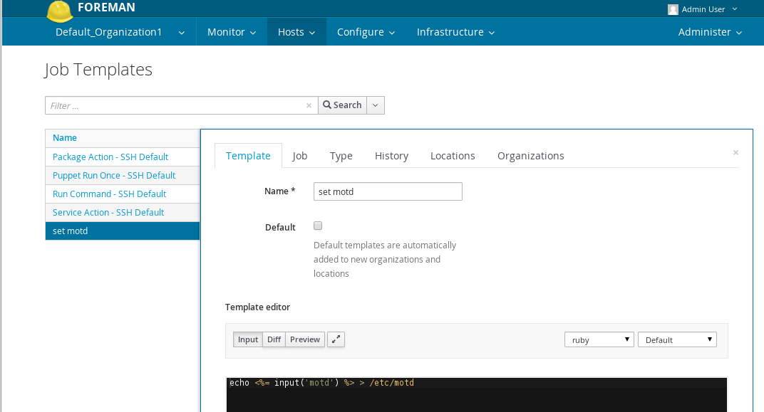

3.1 Job Templates
If you’re familiar with Foreman provisioning templates, you should find writing job templates familiar. First navigate to the Host > Job Templates menu. Then hit the green button with label “New Job Template”.
Note: If you don’t see a menu entry, the Foreman plugin is not installed correctly.
Now you should see a form similar to the Provisioning template one. In first tab you have to fill in Name. You can use input macros in ERB tags which stands for variables which you define in second tab called Job.
Job Template form
Before we get to inputs, lets look at other fields in Job tab. First one is an autocomplete field called Job category. This groups job template together and makes managing a huge number of templates easier.
A description format field is a template for job description. Imagine you run a template named “Install package” 10 times, each time with different package name specified by user input (more about this below). On job overview page you’d see the same “Install package” job and you’d have to inspect provided inputs to find the one that installed let’s say httpd package. Using description format you set your own rules for creating the description. Input values can be used as part of it. A good description format for our install package example would be the following:
Install package %{package_name}
Note that the name wrapped in %{…} is the name of input which value will replace this placeholder so you would see “Install package httpd” if httpd was used for this input. Note that the description format can be modified per job invocation as well so this is just a default value for particular job template. Two extra placeholders %{template_name} and %{job_category} can be used.
On the very same tab you can configure inputs. These template inputs defines values that can be accessed in the template itself. To add new input, click the green button “+ Add Input” which adds more fields to the form. To remove the input, hit the cross in top right corner of the input form.
We support four types of inputs. Each must have it’s name which is used in macro. If my input has the name “motd”, I can then use following ERB tag in my template code:
echo "<%= input('motd') -%>" > /etc/motd

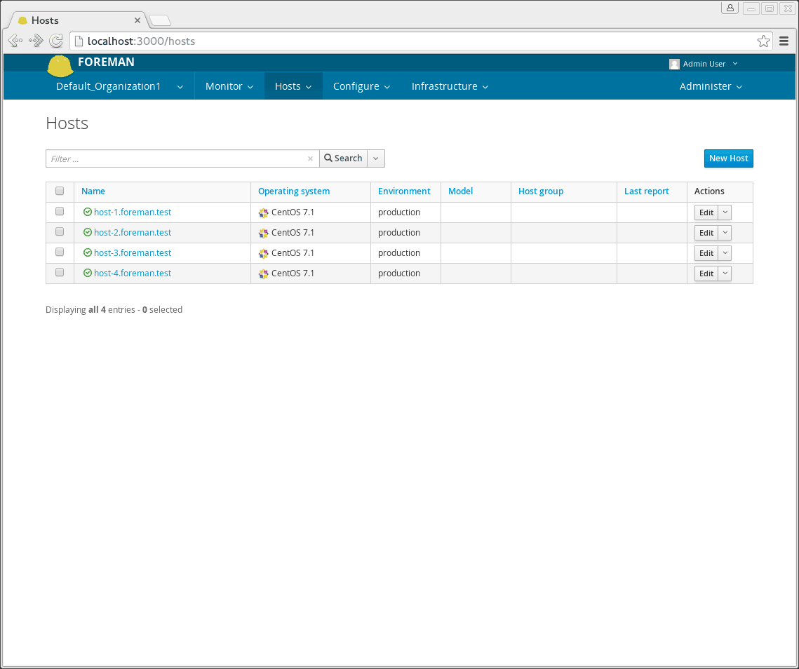

To execute on one host, go to the host detail page and click green “Run Job” button. For multiple hosts, use the bulk action tool on the “All hosts” page to select “Run Job”.
Job Invocation form
In this form you select which Job template you want to run on selected host(s). Then you can see prefilled Search query that uses the Foreman searching syntax. You can customize the query to search any set of hosts, e.g. all hosts running CentOS 7.1 or hosts with 1 GB memory. You can check how many hosts such search query covers by clicking refresh button below.

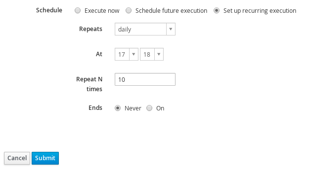

You can also plan the execution in future or configure multiple rerunning. There’s a second tab called Scheduling where you can choose from
  • Execute now - immediate single execution,
  • Schedule future execution - delayed single execution
  • Set up recurring execution - multiple executions on regular basis
Job Invocation schedule form
While execute now is obvious, future time scheduling offers you to customize two things. First is when the job should start, the second one called Start before determines the deadline after which the execution shouldn’t start. This can be useful when you have some maintenance window and if the execution gets delayed it wouldn’t be safe to run when the window was closed.
When setting up recurring execution there are many ways how you can specify the interval. You can choose from hourly, daily, weekly, monthly interval basis and for advanced users there’s option to specify custom cron configuration. This way you can setup various intervals, for example
# Run on every second Sunday of every month
0 4 8-14 * *
# Run every 5 minutes during 6 AM and 6 PM
*/5 6,18 * * *
You can specify the number of runs as Repeat N times attribute or limit it by Ends at date. What happens sooner takes precedence. You can keep the invocation configured without any fixed ending condition. If you want to stop such job later, you either cancel the job and cancel the recurring logic.

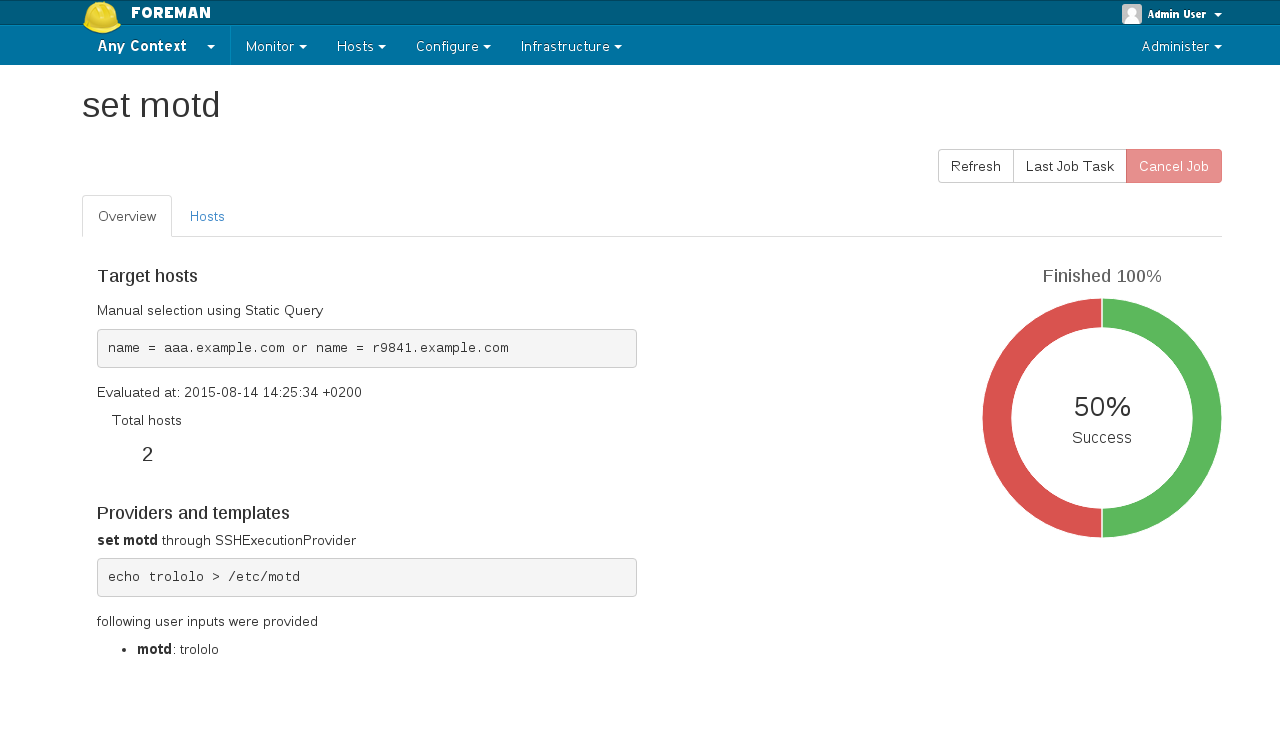

3.3 Job detail
On the Job detail page you can see overall progress and result of the job execution.
Job detail 1
In the overview tab you can see what query was used to find the hosts and how many hosts were found using it. Below is the evaluated template in generic form. If there were some fact or parameter inputs used, you will see only placeholders for them since they are specific to each host. User inputs are evaluated since they are same for all hosts. A chart is showing the status of the job on all targets.
From this screen you can even cancel the job if it’s not finished yet. First cancel attempt will try to cancel the run on the Smart Proxy. If proxy does not respond, you can hit the cancel button a second time which forces the Job to be cancelled on Foreman (while it still might be running on Smart Proxy). Last Job Task takes you to Foreman Tasks that represents this Job.
In Hosts tab you can see all hosts targeted by this execution, status of the job on them and link to Foreman Task that represent the execution for a particular host. Note that this task is a subtask of a whole Job task.
If you scheduled a recurring you’ll also see Recurring logic tab. This gives you some basic information, e.g. when next run is supposed to happen. After you cancel the job, it cancels all future executions as well.

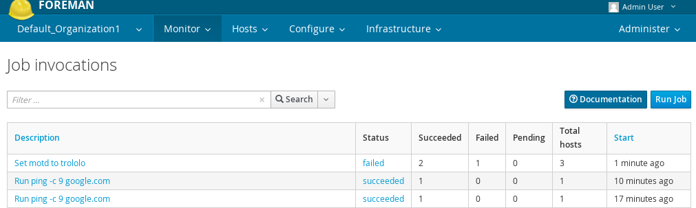

3.4 Jobs list
You can find all Jobs when you navigate to Monitor > Jobs. A table lists all jobs from history to future. You can search jobs by description with a query like
description ~ set*
This example would find all executions that run job which description starts with “set”. Similarly you can search based on job category using keyword job_category.
Job invocations list
Each Job has a status which tracks the progress of the execution. A status value can be one of
  • queued - job invocation was saved and has not start yet, either background processor hasn’t picked it yet or it was scheduled in future,
  • running - background processor picked the job, we might have patial update but it is not finished yet,
  • succeeded - job has finished sucessfully,
  • failed - job has finished with some issue,
The same status is recorded for host as execution status after each job execution that targeted it. You can search for hosts using following search syntax
execution_status = ok
execution_status = error
The first example would find all hosts last job execution in state succeeded and hosts that have no job. The second returns hosts with failed last job.
If the job has more than one target hosts, the overall status is composed from statuses of all targets run. If execution failed on any of target the overall result of job would be failed. Similarly it succeeds only if all targets suceeds. Note that the status can be running if 99% targets already finished the job since the overall job is still waiting for the rest.
A start column tells us when the task started or is planned to start if it was scheduled to future. You can use it in search syntax as start_at. There’s also other similar attribute called started_at which holds information about when the task was picked by background processor and started in fact.

4.4 Writing custom templates
During writing your own job templates you might find some of following macros useful.
4.4.1 render_template
You can render a template from another template and feed it with inputs. A short example follows
<%= render_template 'Package Action', :action => 'install', :package => 'httpd' %>
chkconfig httpd on
<%= render_template 'Service Action', :action => 'start', :service_name => 'httpd' %>
For more information, see Job Templates
4.4.2 preview?
When you need to render a different output for preview of the template, you can user preview? macro. This is useful if you need to hide some sensitive or spamming part - e.g. private or public key content.
<% if preview? %>
  PUBLIC_KEY_STRIPPED_OUT
<% else %>
  <%= input('public_key') %>
<% end %>
Also when you disable safe mode, you might touch internal Foreman objects. Imagine you have a template for deleting puppet certificate that first deletes the certificate on puppet CA through Foreman objects and then removes it on target host.
<% if preview? -%>
#   this would delete a certificate on puppet ca, but running in preview mode
<% else -%>
  <%= @host.puppet_ca_proxy.statuses[:puppetca].destroy(@host.name) %>
<% end -%>
rm -rf /var/lib/puppet/ssl/*
In this case, previewing of the template would immediately trigger destroy method and therefore it’s wrapped in preview condition.
