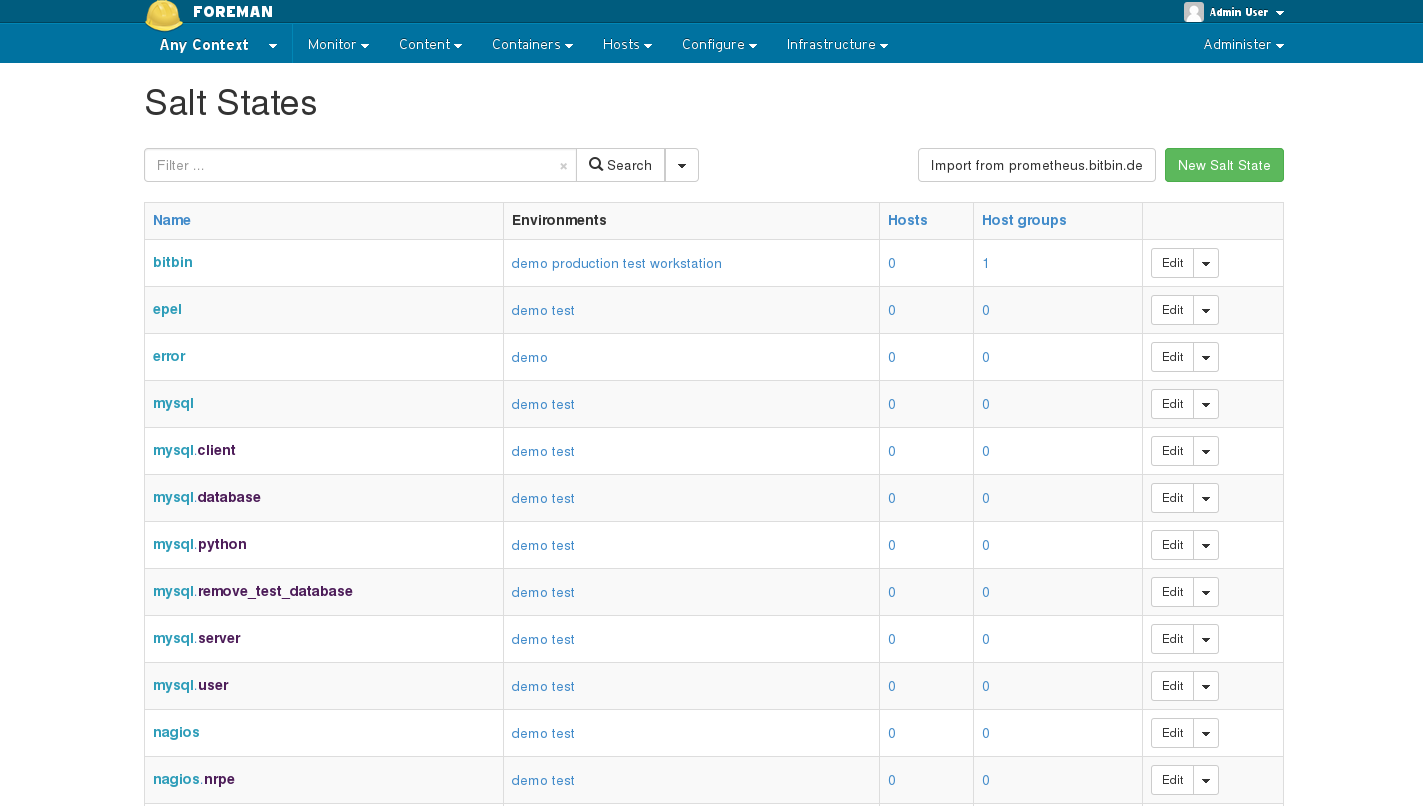

/etc/salt/minion is configuredsalt-call --grains is run in order to trigger key signingFrom the States index page, you have an overview of all the states from your Salt master, and the environments they are available in. To refresh this data, use the Import button on the top right of the screen.
