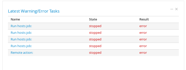

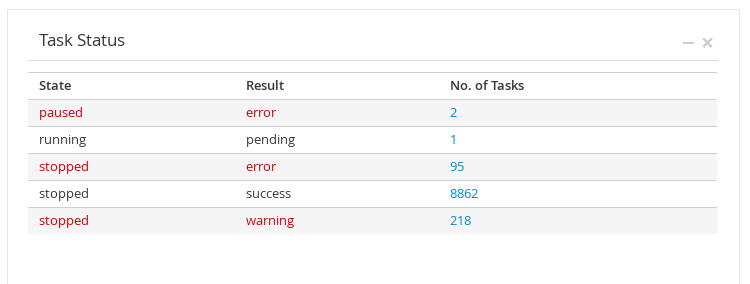

To get a quick overview of tasks status, you can use two dashboard widgets provided by the plugin.
Widget Widget
