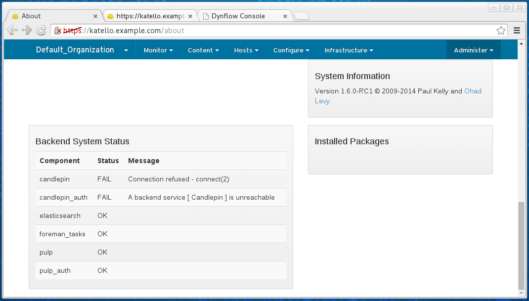

The status of back-end services can be found either from the Web UI on the /about page:
Backend systems status

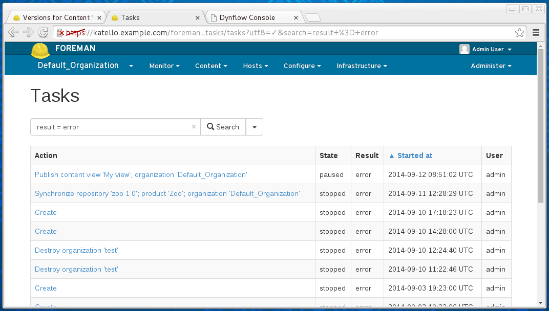

To see all the tasks in the system, one can go to /foreman_tasks/tasks page. To see all the tasks that failed, one can search on result = error:

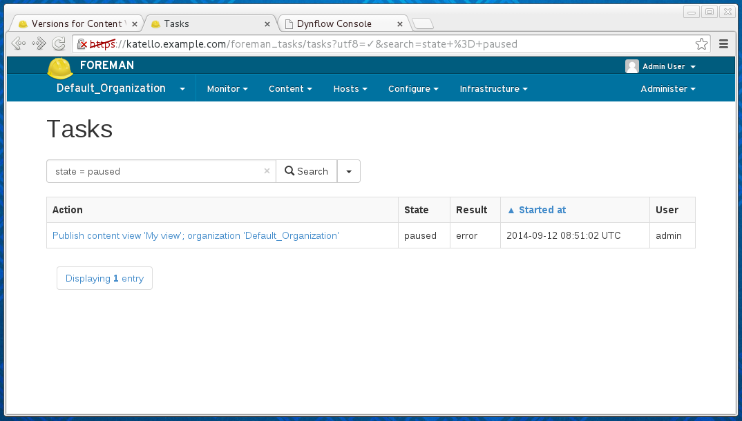

To see all the tasks requiring further assistance, filter on state = paused:
Paused tasks

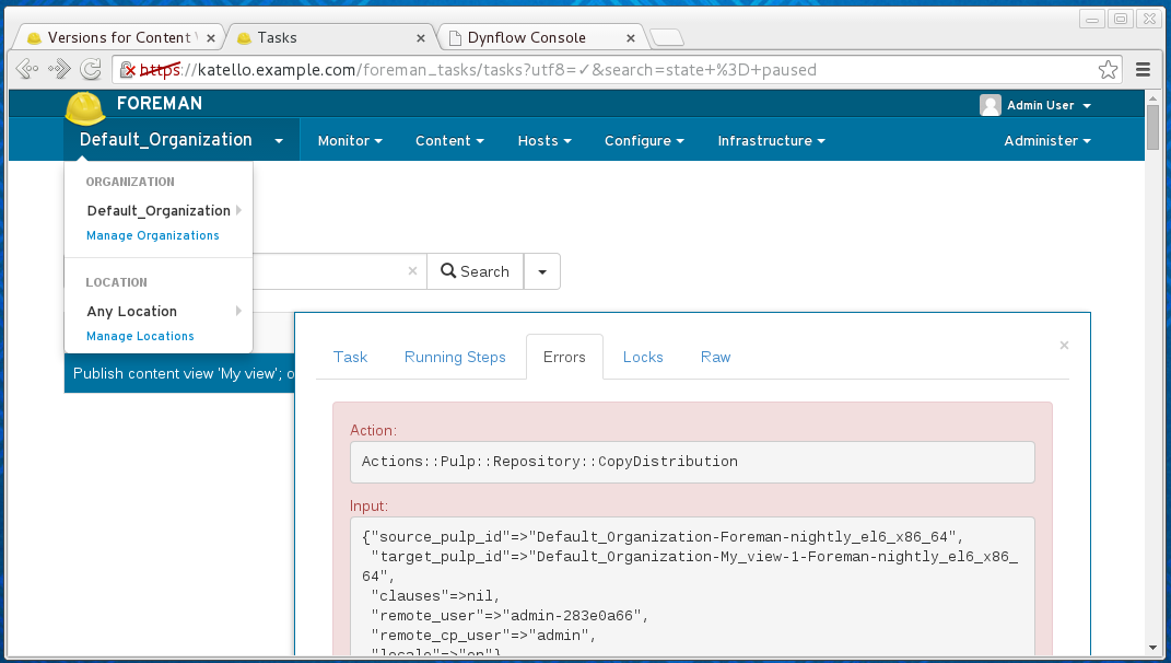

Once the paused task is identified, one can investigate the problem causing the errors:
Task error details
The resolution of the problem is dependent on the error details. The task may be resolvable by resuming the task: make sure the sub-services are running (see Sub-services status for more details) and then click ‘Resume’ within the web interface.

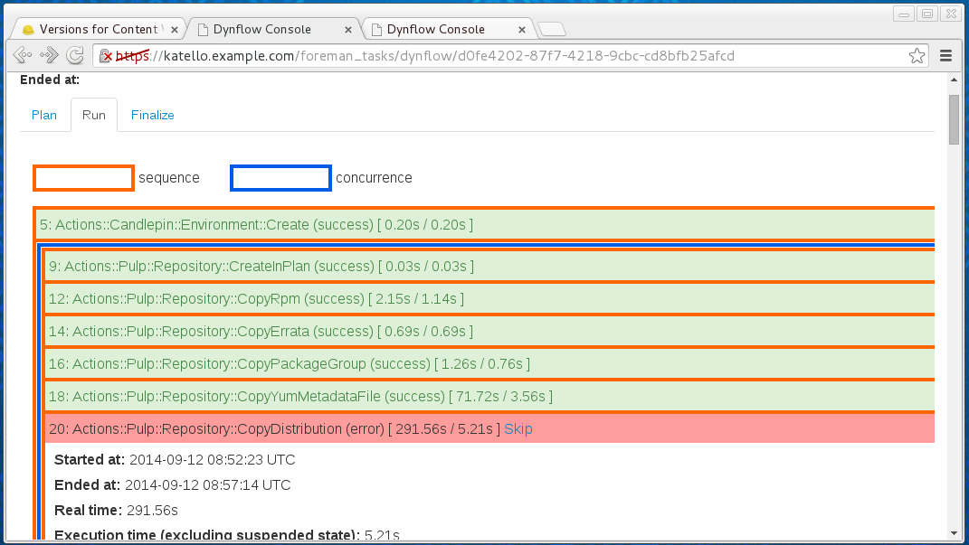

If this still doesn’t help, one possible step is going to a Dynflow console (the button from task details takes you there):
Dynflow console
Caution: Dynflow console is considered a low-level tool and should be used very carefully, ideally discussing other options before using its features
If the failed task was taken care of by other means (performing the failed steps manually) or it was identified as not critical to the whole task, one can skip the failed step and resume the task to continue. These tasks end up with warning result at the end, to indicate there was some difficulty during the run.

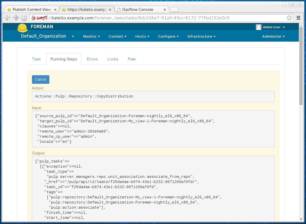

The first place to look in this case is filtering the tasks on state = running and looking at Running Steps in the task details:
Running Steps
In this case, the "start_time" => nil indicates that the task was not picked up by Pulp, which usually means some issues with running the Pulp workers. See (see Sub-services status for more details).

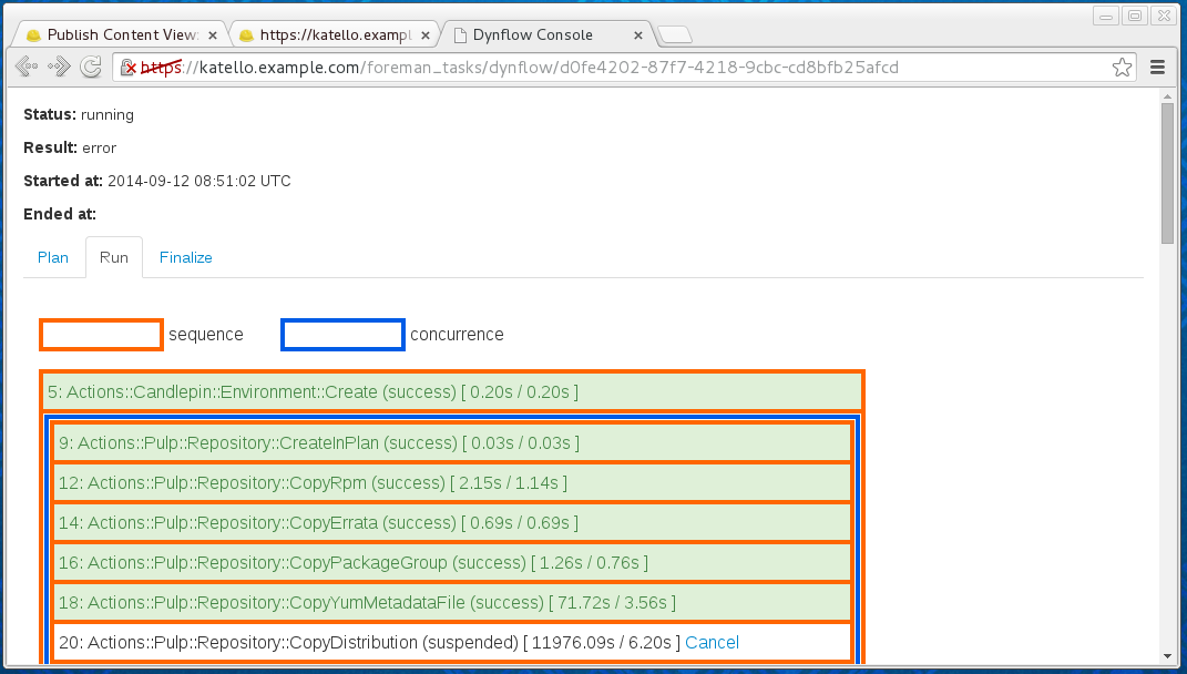

One can also go to the Dynflow console for even more details: the suspended state means that the step is waiting for the external task to finish - the suspended state itself doesn’t have to indicate any error:
Dynflow suspended step
If you’re sure the underlying services are running fine, depending on the type of task, there might be a possibility to cancel the running step and possibly following dealing with paused tasks instead.

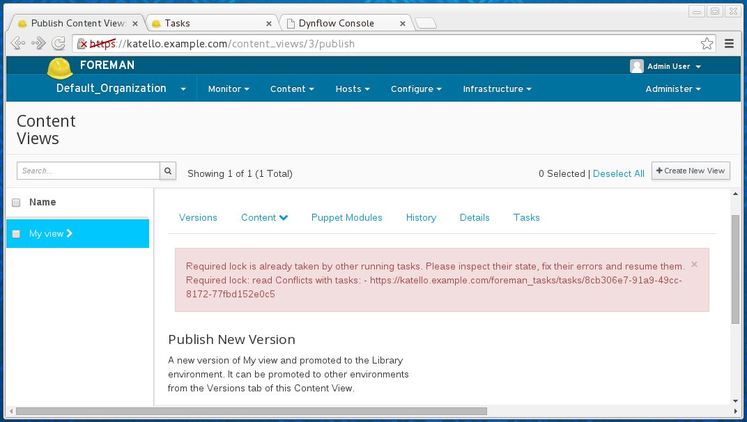

Locking
Foreman tasks provides a locking mechanism which is important to prevent the possibility of operations colliding that are being performed concurrently on the same resource (such as synchronizing and deleting a repository at the same time).
When trying to run an operation on a resource that another task is already running, one can get Required lock is already taken by other running tasks.:
Lock error
A locked resource is one where another task that is related to the same resource is already running. Thus, the task being attempted will result in that task being tried in running or paused state. This means that the error is triggered also in cases, where there is a task with unresolved failure (see dealing with paused tasks for more details).
In rare cases, it might be hard to get into the stopped state. There is a possibility to unlock the resource in the running/paused task. This will switch the task into stopped state, freeing the resources for other tasks. Caution: unlocking allows running other tasks to run on potentially inconsistent data, which might lead into further errors. It’s still possible to go to the Dynflow console and resume the tasks, even after using the unlock feature. There are two unlock-related buttons: Unlock and Force Unlock. The only difference between these two is the second one is allowed even when the task is in running state, and therefore is potentially even more dangerous than the Unlock button. See dealing with tasks running too long before attempting to use the Force Unlock option.

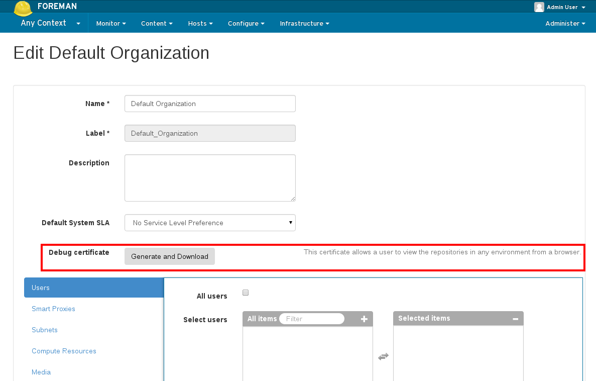

Debug Certificate
Debug certificates (also called Ueber Certificates) can be used to unlock all the content for a given Organization. These are meant to be used by sysadmins who are debugging issues with the Katello install.
Generating a Debug Certificate
To generate a debug certificate for a given Organization from the UI, navigate to the organizations page and click on the organization for which you want a debug certificate. Click on the button to generate and download the certificate as highlighted below:
Generate Debug Certificate
To generate a debug certificate using the API see the API docs located on your server running at /apidoc.
