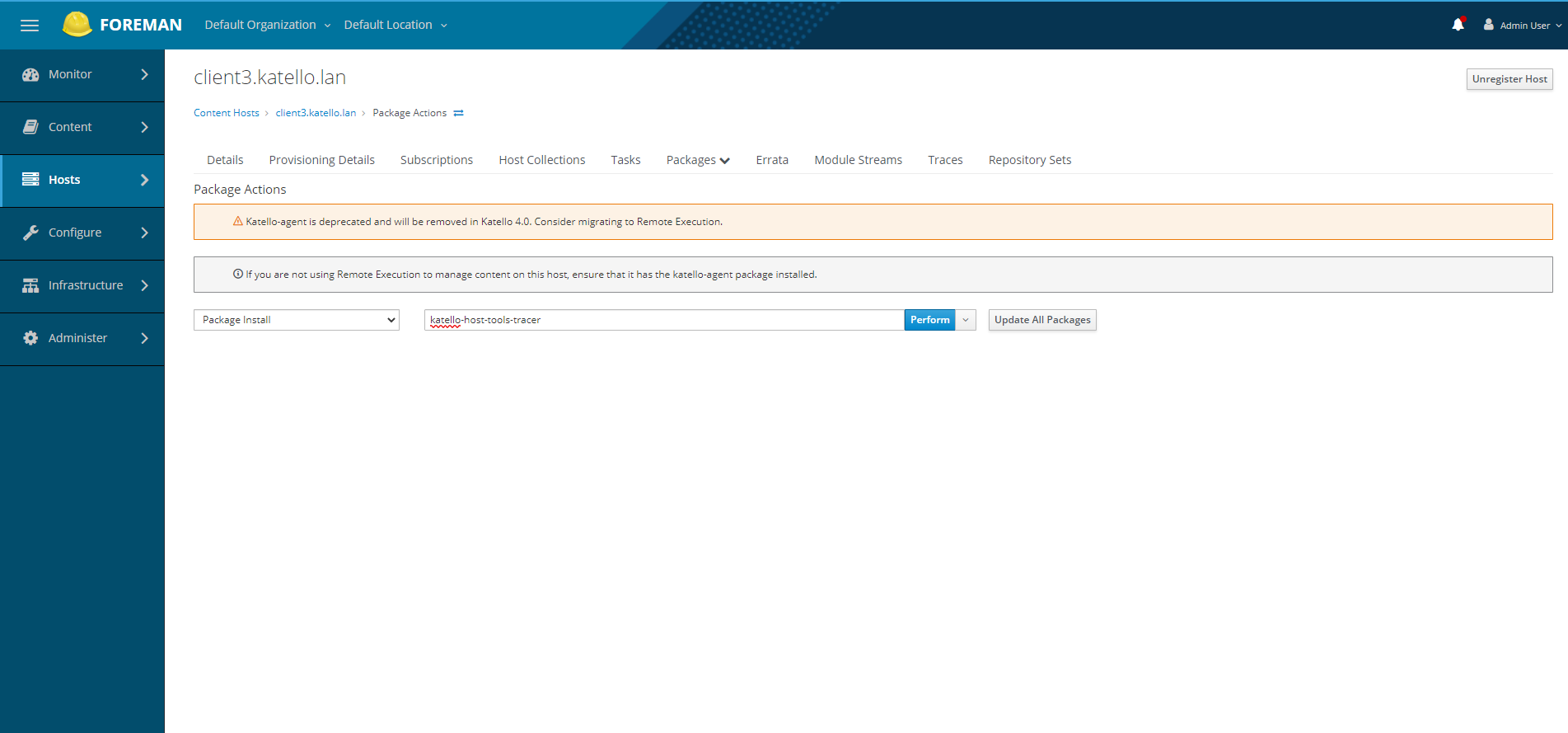

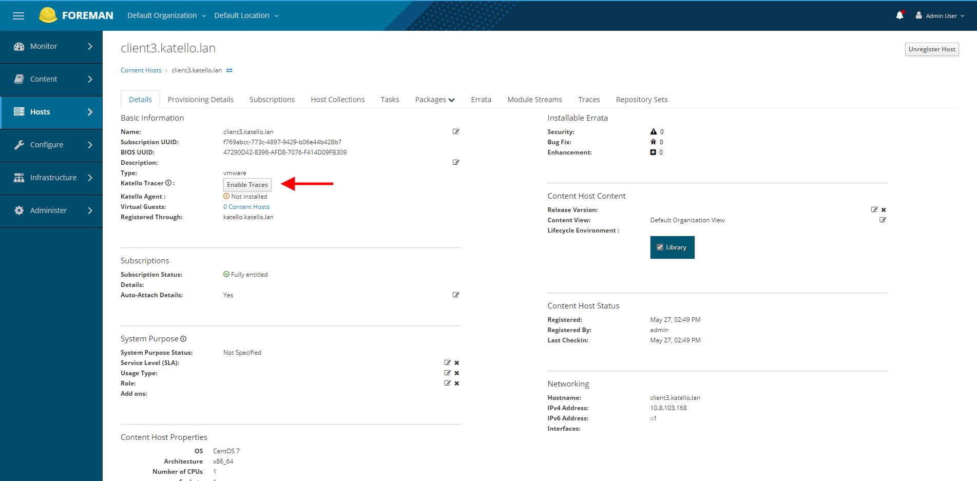

With the UI
Go to “Hosts” - “Content Hosts” in the Katello UI. Click on the host name you will be installing Tracer on, click the button labeled “Enable Traces”:
Install Tracer UI
Clicking “Enable Traces” on the host will take you to the Package Actions page to confirm installing the katello-host-tools-tracer package:
UI Tracer Install Package Perform
Clicking “Perform” will kick off a Remote Execution job to install the katello-host-tools-tracer package:
Install Tracer Job

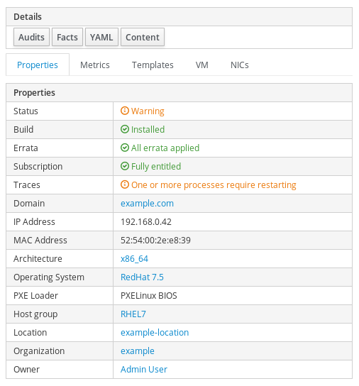

Viewing traces for a content host in the UI
To verify that Katello is receiving Tracer information from the client, within the Katello UI, go to “Hosts” - “All hosts”, and click on the name of the host that Tracer was installed on.
The host should now have a “Traces” property:
View Host Trace Status

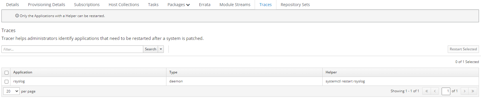

Go to “Hosts” - “Content Hosts” in the Katello UI. Click on the host name, and go to the “Traces” tab to see more details:
Host Trace Details

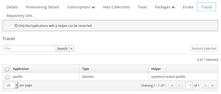

Resolving traces for a single Content Host
View Host Traces

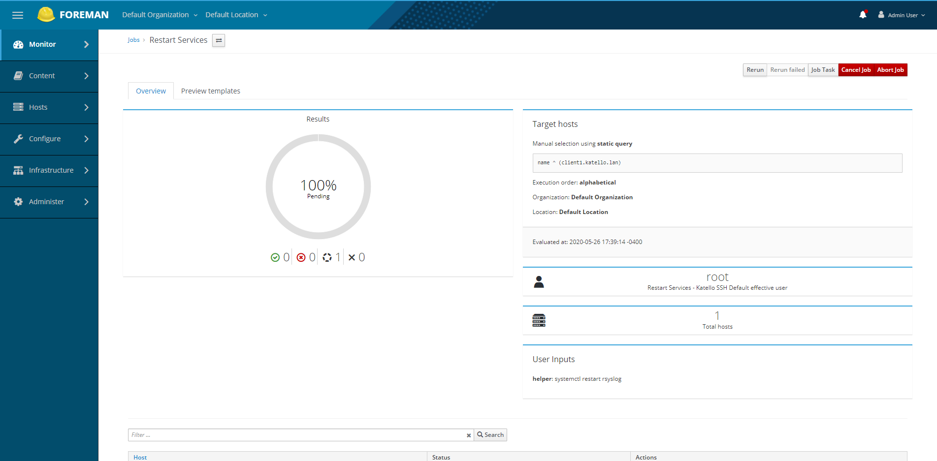

Tracer is recommending that rsyslog be restarted. Click the box for rsyslog, then click “Restart Selected”. Katello will kick off a Remote Execution job to restart the rsyslog service.
Single Host Trace Job

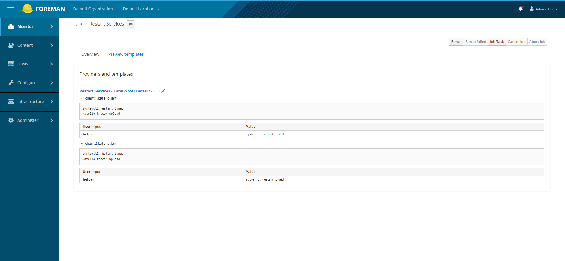

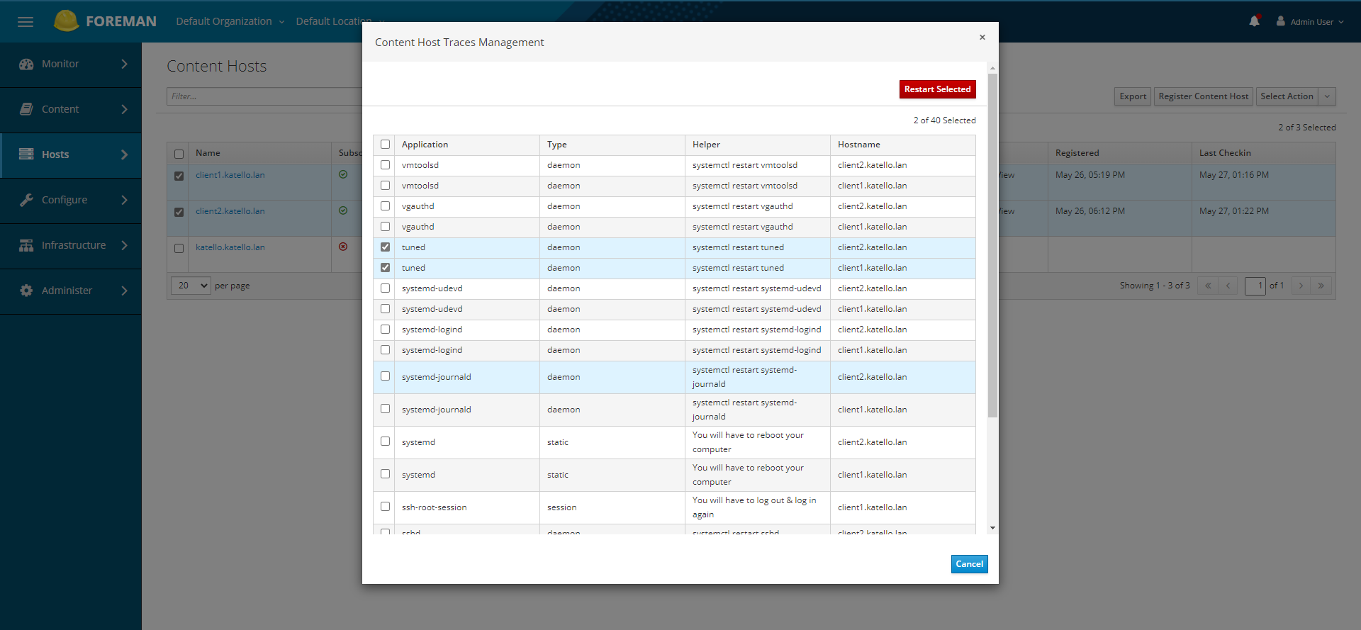

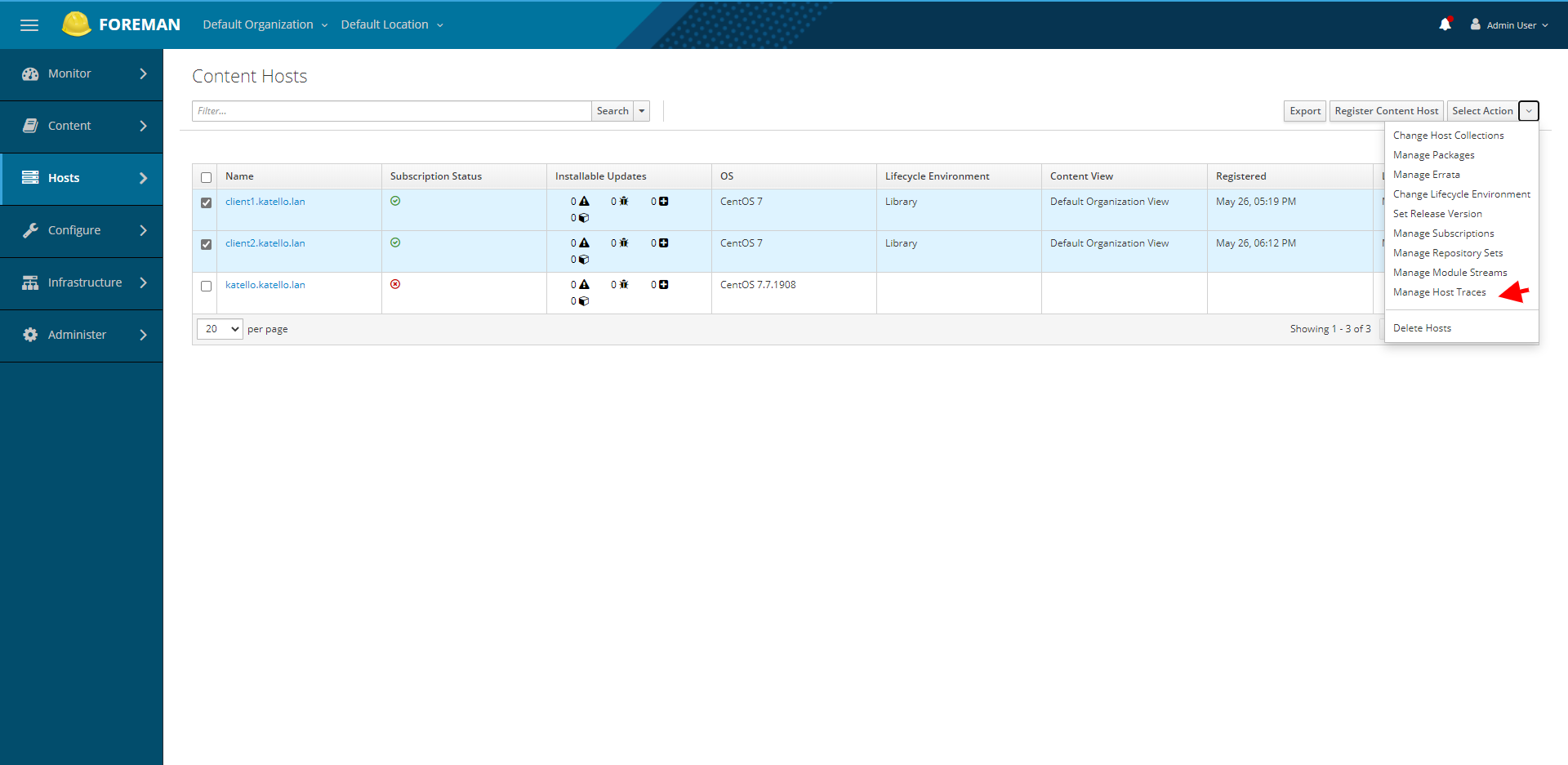

Resolving traces on multiple Content Hosts
Visit Content Hosts and select the hosts you would like to remediate traces on:
View Bulk Host Traces
Select the services from the list that you want to remediate and click “Restart Selected”:
Bulk Host Traces Select
You will return to the Content Host page with a notification and a link to view the job invocations that have been kicked off with Remote Execution:
Bulk Hosts Traces Job
